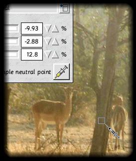

![[Pic6/Jpg]](pix/cbr/Pic6.jpg)
Remember to hold down the Alt key
Here's the result. As a further adjustment, I boosted the contrast slightly (Image processing:Gamma:Increase contrast). If you like, try some slight sharpening.
