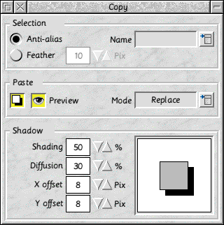

People do seem to have difficulty generating drop shadows in Photodesk. It's not that hard, but perhaps there's an expectation that it should be possible with a single mouse-click. In order to use Photodesk's built-in drop-shadow facility, you need to make a selection, copy it somewhere, set up the shadow parameters, then paste it back to the original location -- and selection, copying and pasting can all be quite involved procedures.

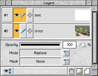

The solution is to use a layer for your text, a method with many advantages. Here's a step-by-step run-through of creating a drop shadow using layers.
